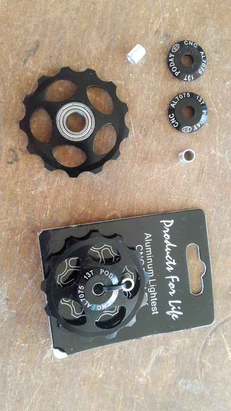

Idler pulley
Those idler sprockets would indeed work.
A few points of concern would be...
  • They are usually not available to fit bicycle chain (especially thinner shifter compatible chain).
  • They are probably not available in 4-6" diameter for bicycle chain.
You could try "machining" one down by attacking it with a flap disc if you can find at least the correct pitch.
