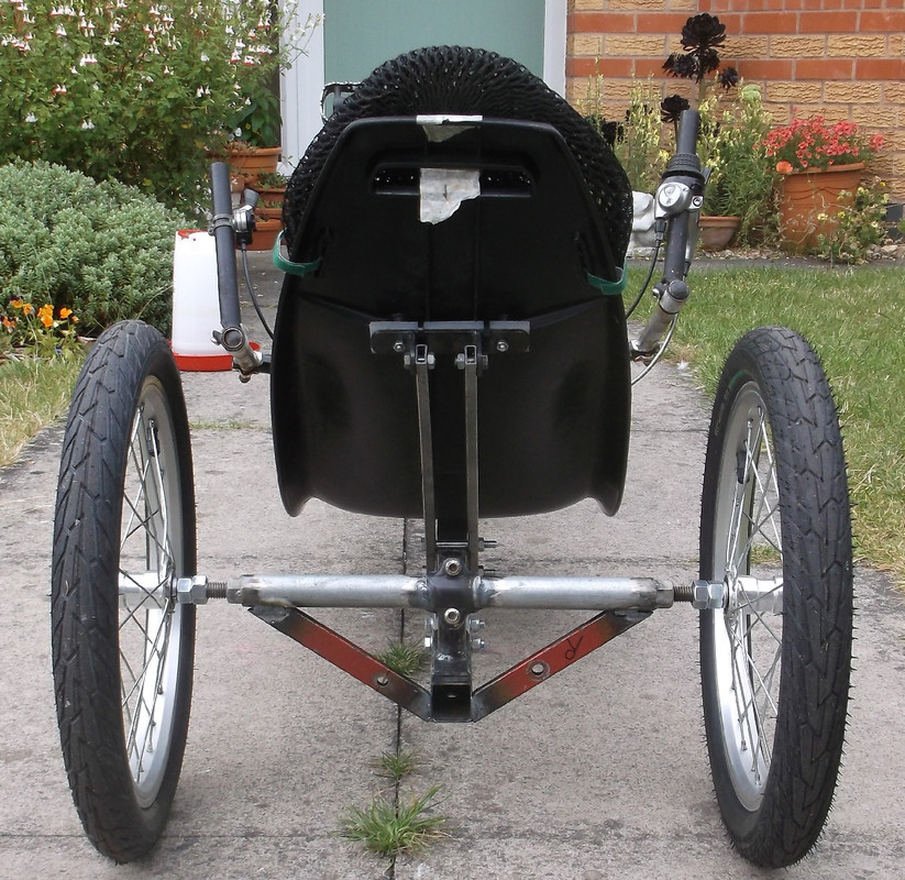

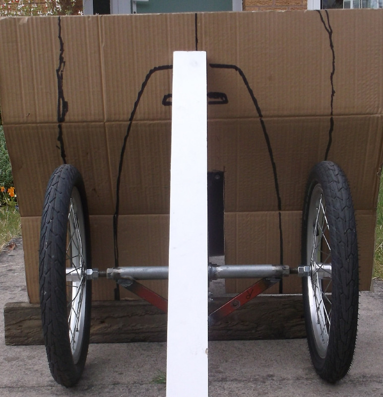

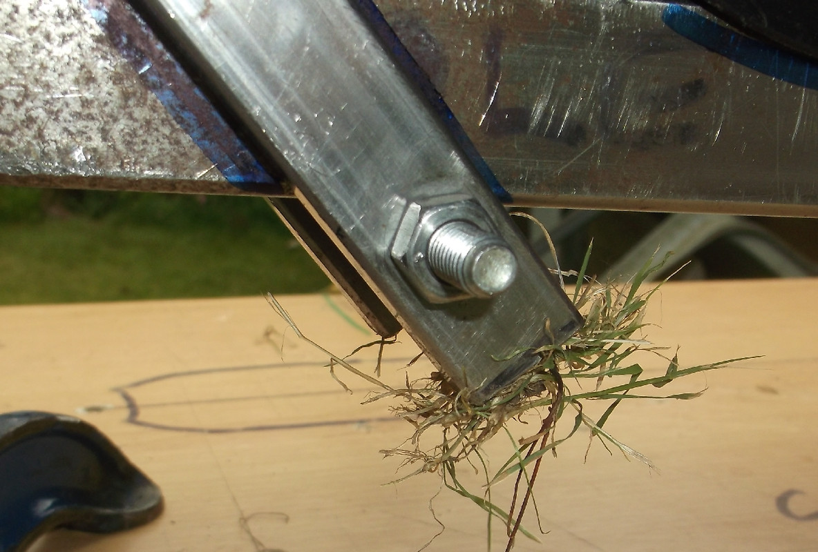

Rear not at minimum width , 18" tyre centres
Enlisting the help of a neighbour he discovered the creaking and general sponginess when the trike was rocked/crossed camber was down to the 2 bolts not holding the rear axle in tight enough , I wanted it removable for slowly reducing the width to see how narrow it could go and still be safe ?
No time for that now so narrow axle fitted it can go down to 16" width if I feel I need it , however currently running @ 18" so welded up original clamp and 2 braces added [ would that make it belt and braces ? ]
So how wide is that actually ?

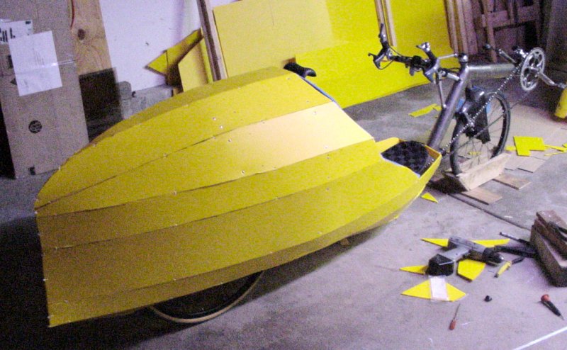

Sorry for white bit of wood , card has a drawing of the seat in the middle and the 2 outer lines follow my body contours , so if we allowed say 1.5" more per side it looks like the wheels could be enclosed in a fairing ?
Manipulate this for bit fatter and shorter should do it , with the wheels poking out the bottom
All for now Paul

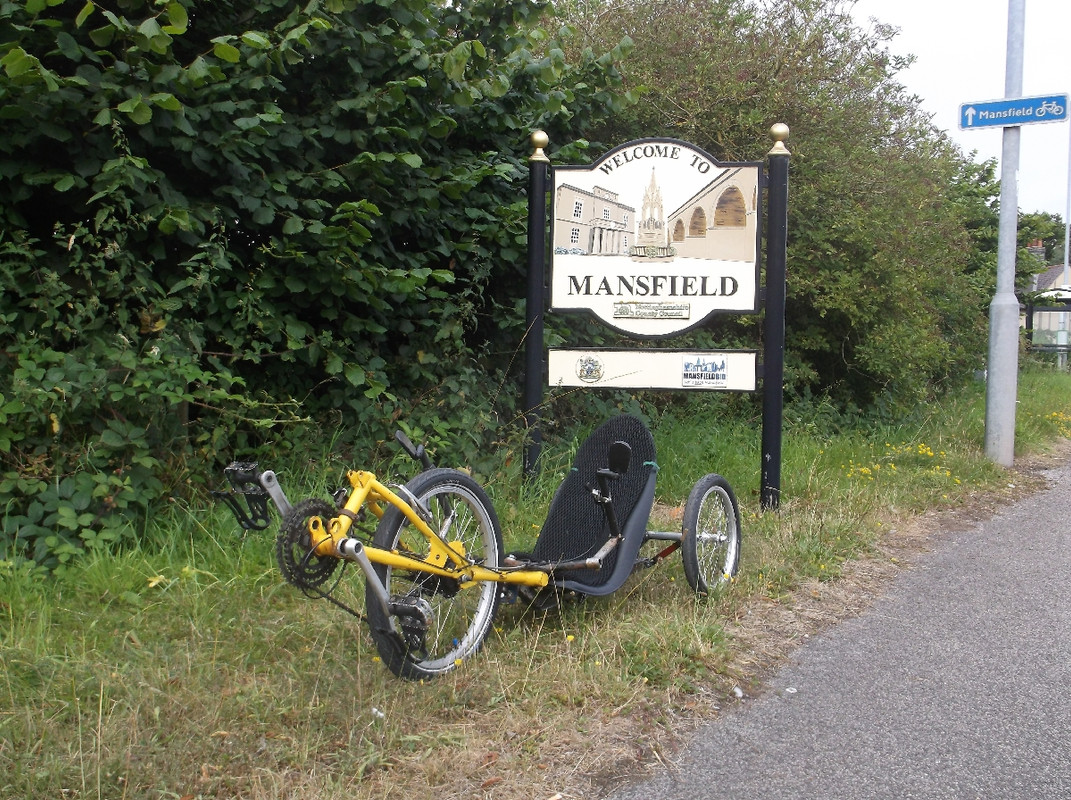

So I needed to bite the bullet - D-Day is here to paraphrase ' go out on it or go home '

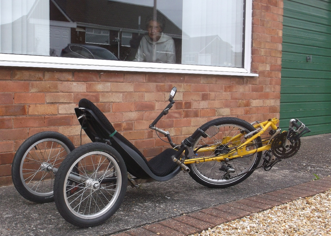

So yes I left Mansfield this is about 1.5 miles from where I live.
Next into the ' badlands '

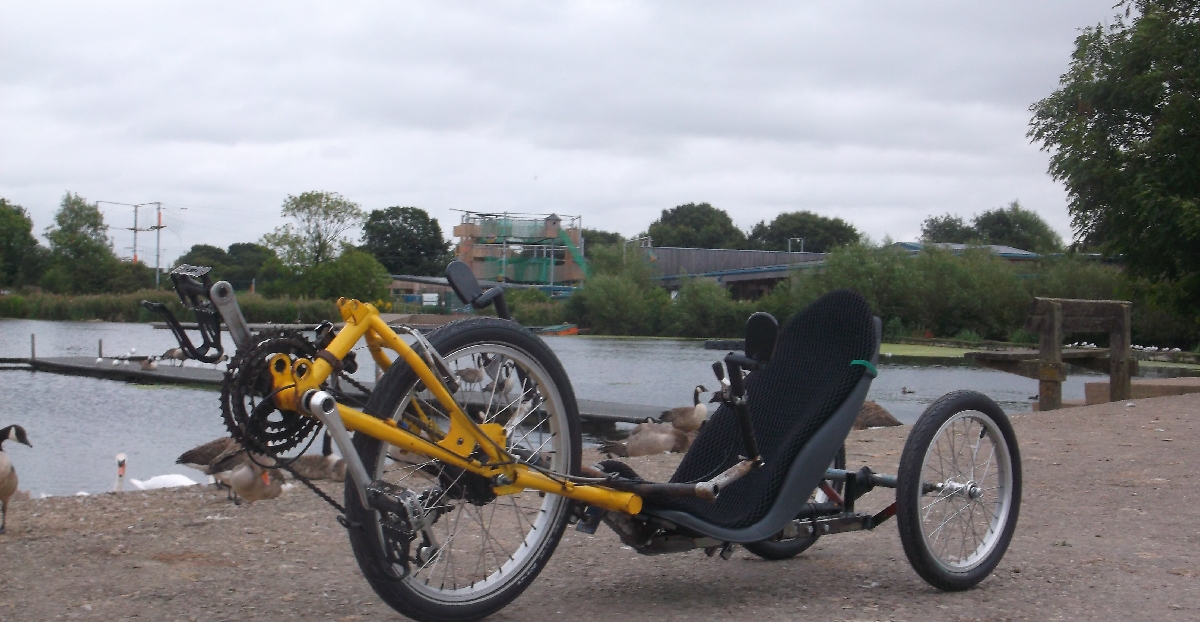

Now 5 miles from home , stopped for a scenic shot , hard to tell wheels are 20" and 2 x 16" they look much bigger.
Normally mum would come out and take a picture with me sat on any new device however she is suffering from Sciatica and could not make it out or stand to use the camera , so give her a wave...
So no real dramas however it is very very lively when the surface is rough I though a couple of times it was bouncing so much it might tip over however it stayed upright. Speed is hard to judge , it is certainly higher gear than my other Pythons and I was able to pedal down hills I had to previously free wheel down however until a speedo is fitted who knows.

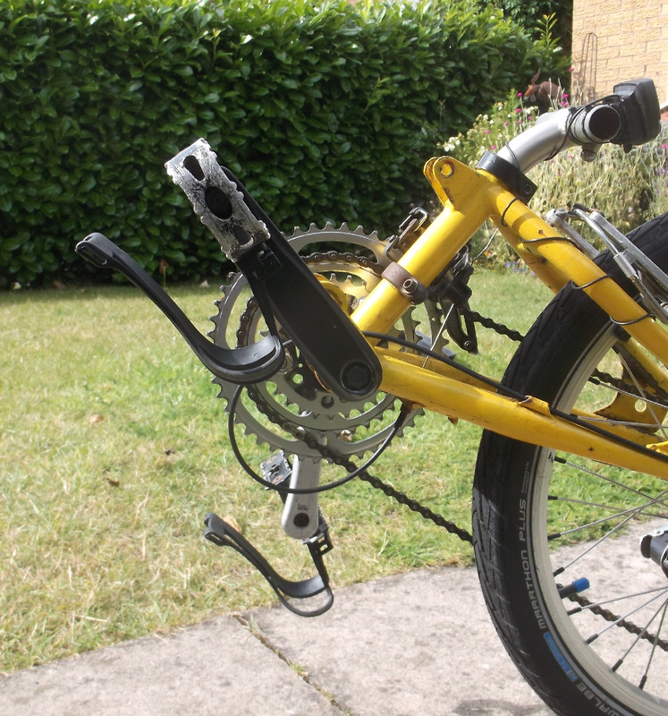

Hold on a minute current ride has 155mm cranks and low racer has 170mm cranks wow nearly 3/4" to far for my legs.
So i have swapped the 170mm for some 155mm however that has down geared it to 24T - 32T - 42T and I can't get in the 42T as the crank offset is to great and the front mech does not want to go over that far.
So whilst I now know my speed I don't have the right gearing , I have a plan I have some 155mm alloy cranks with 2 steel rings where the rivet holes in the steel spider perfectly match the mounting holes for ali Stronglight rings where I have a choice of 50T - 48T - 38T - 34T - 26T so I will try either a 50T - 38T 26T or a 48T - 38T 26T.
Mums tomorrow a low gear event ;) then crank building.

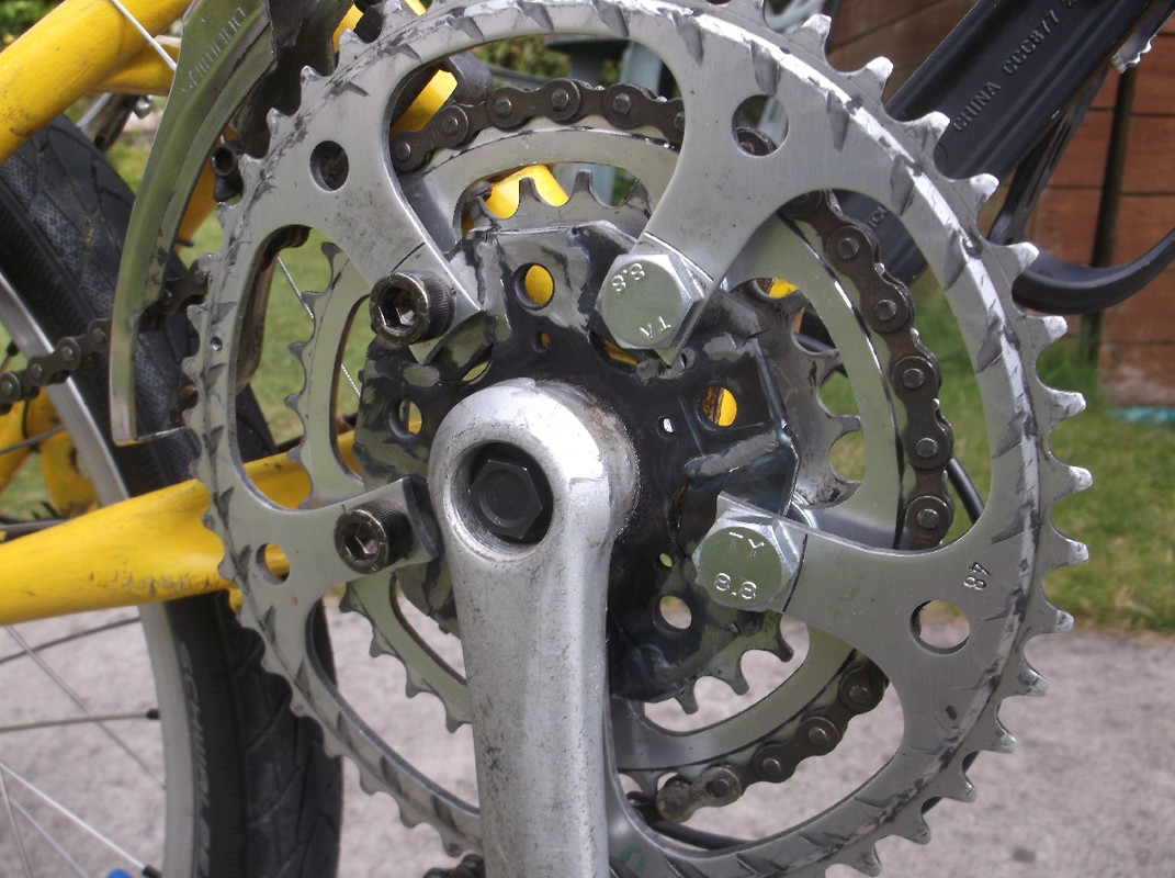

I needs some 155mm cranks with at least a 28t-38t-48t rings.
This is what I have to work with :-
So have enough rings [ 36t will be an advantage up the hills around here ] on the right is a alloy crank with a steel spider I can weld to.
This is what I have built for testing [ needs better bolts ] with either lock nuts or Locktight tried to pedal it off the drive wow this feels weird what have I done ?
Original crank in black new one in silver ! DOH
Soon fixed and I can get the 36t and the 48t however I can't get to the smallest ring despite adjusting the stop right out , I think I have the ring spacing wrong and they are about 5mm to close to the mech post , just a matter of fiddling with some washers [ I hope ] still don't need smallest ring for racing ...

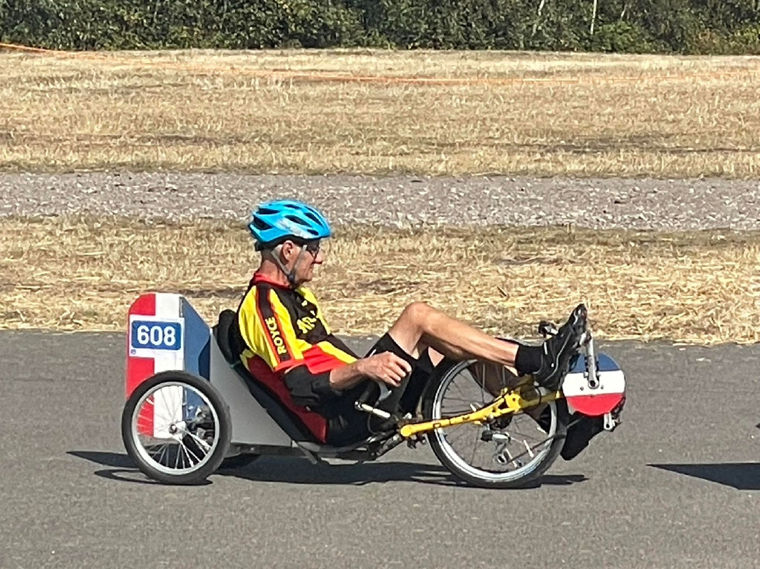

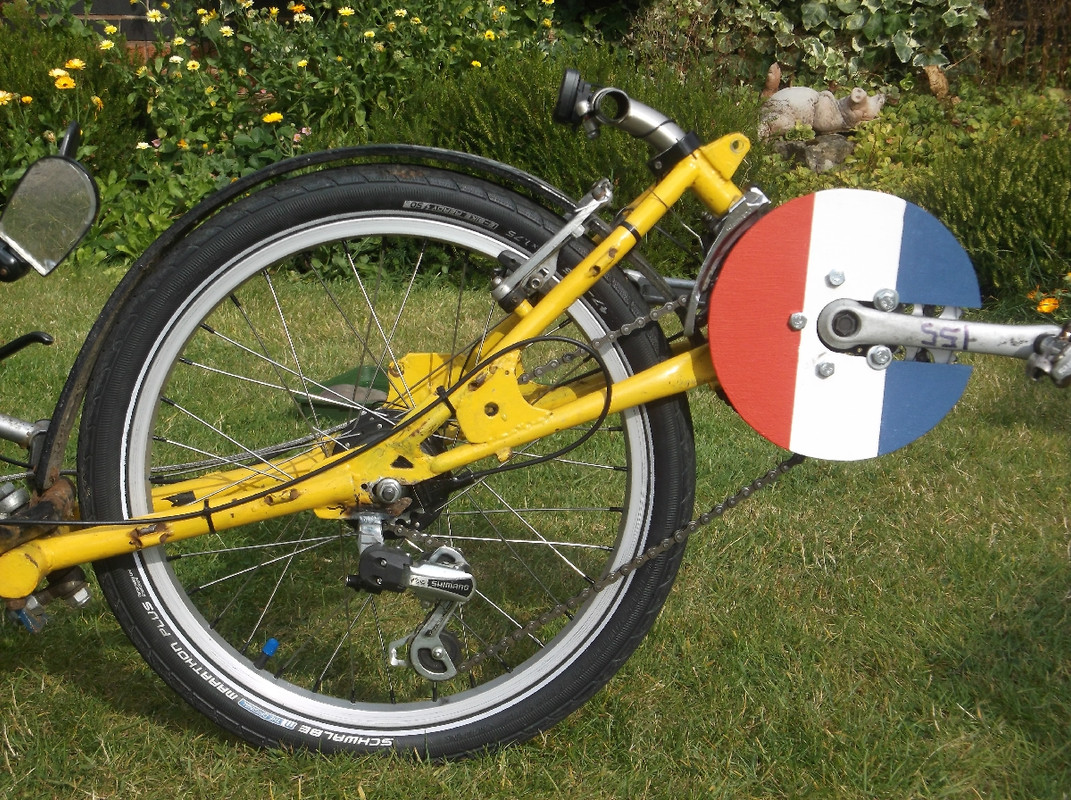

To conform to the racing rules I needed 2 things not normally considered on a leisure machine:-
First is a chain protector so I chewed this out of some plywood and gave it a couple of coats of emulsion to brighten it up , that was indoor paint so lets hope it doesn't rain !
Now the rules about displaying numbers and timing tags say :-
If your HPV does not have an appropriate surface, consider constructing a ‘fin’ from cardboard/plastic and
adhesive tape to attach it to.
Think I nailed that ? ;):D
Need to paint the front white part either magnolia or maybe a fern green if either of the old tins actually work ....

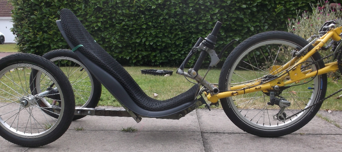

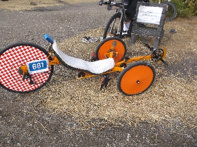

Total package :-
Next up need some M6 & M8 lock nuts and go over it with a fine tooth comb checking all tight and lock nutted up.
Paul
180 degrees on that crank and you are displaying a French flag. Possibly a similar display on the other side of the fin too.
So I am back and the trike survived and did all that was asked of it.

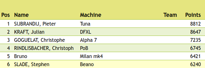

This is part of the overall ratings table :-
So these were the top 6

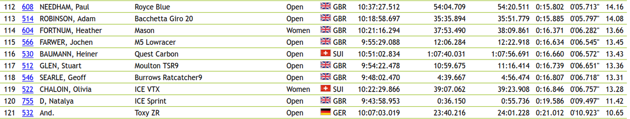

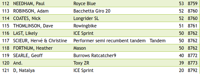

I have be miss classed as driving the Royce Blue car which I only used for the 1hr event.
However NOT last phew 9 below me.

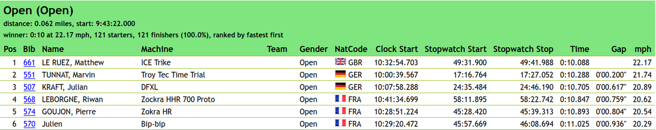

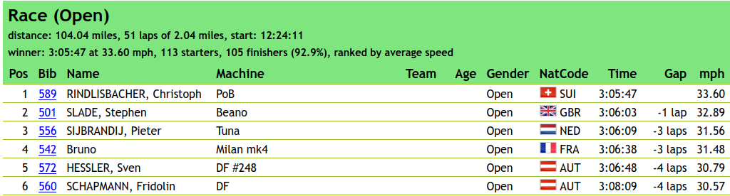

So first event Saturday Standing start 100m - uphill very hard for the 2 wheelers and anything weighty :D
Top 6 again
And here is me beating 9 others - unbelievable - however so SLOWWWW

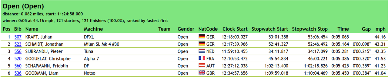

Next a 300m run up to a timed 100m downhill
Top 6 again
As predicted I ran out of gears before I hit the finish line so a poor performance.
After lunch there was a 1 hour race , turns out my lack of power , the hills and the limited gearing of the pedal car made this very hard work.
Sunday started with a 1 lap TT , there are currently no results available for that
Afternoon a 3 hour endurance race , seems the trike is the best option so off we go.

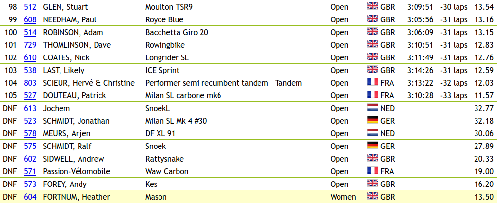

Top 6 again
and me 99th wow beating 14 !
I had 2 x 5 minute breaks to take on water and food , maybe without them I may have beaten the guy in 98th place.
Without the breaks there was every possibility I would not finish as the weather was very unsuitable for a 3 hr race close to 28C for most of the race.
There was loads of great machines there and lots of people to talk to , another 6 pedal cars and lots of the BHPC people I have met over the years.
