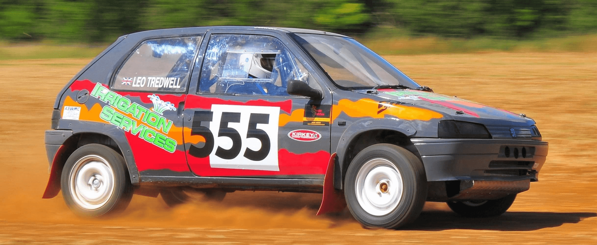

Autocross is what you (and Mini) want / need - A chance to put that poor, under-utilized, wee beastie through its paces ;)
Surely, there must be one being held within range of you, somewhere.
But, you may want to look outside Mini-dom to find one :
We shall await the report of your best time ........
I just read the UK rules - Wow - VERY different from the US!
You may not want to do it, unless you don't mind Mini getting dusty and adding mudflaps ?
Here, the events are held on a paved surface - No mudflaps
PSS - What I was thinking of would be called "Autoslalom" on your side of the pond - That's what you want :)

Yes, Autocross isn't for the faint-hearted or those that don't want their pride & joy battered beyond all recognition I think.
I shall pass on this tempting offer of introduction into motorsport. :)
