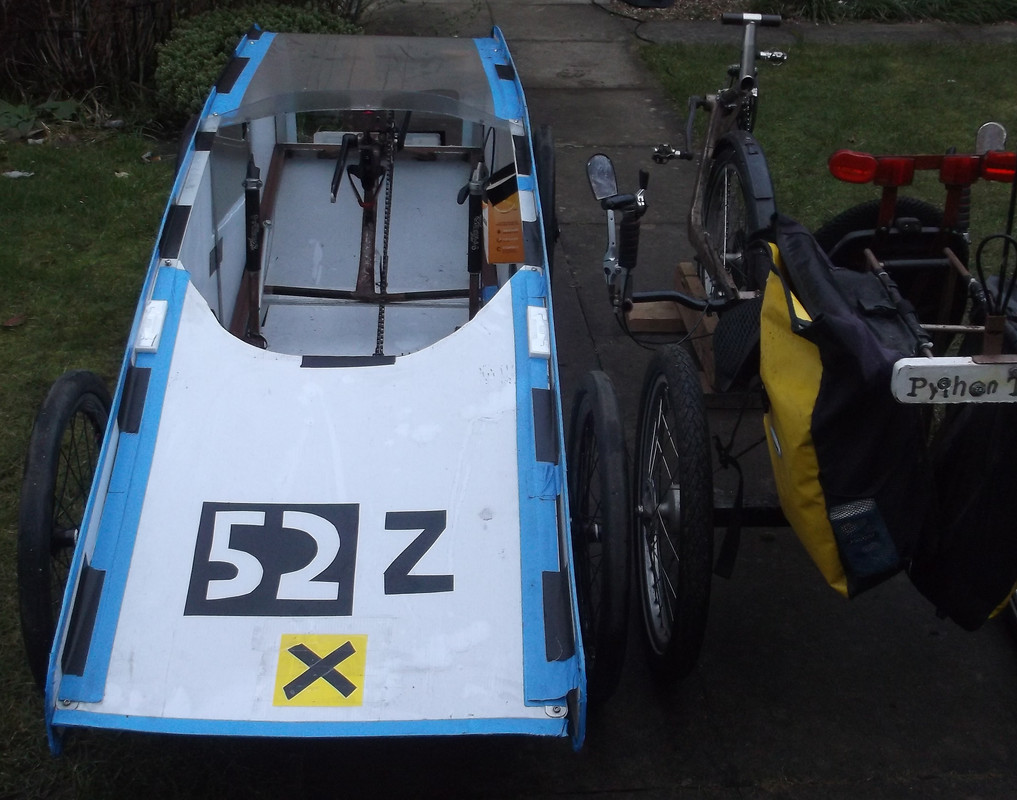

In the above pictures/videos it does look rather tall till you see it next to my Python
Now on the pedal car your head can barely see over the body work as the seat is extremely low !
Eye line picture
Despite the on first glance crudeness of the body shape , this picture suggest it is definitely more streamlined than the Python !
So it needs a little work before I can start my 3 times a week ride in it , however I will be a driver and NOT a rider as I sit in it not straddling it.

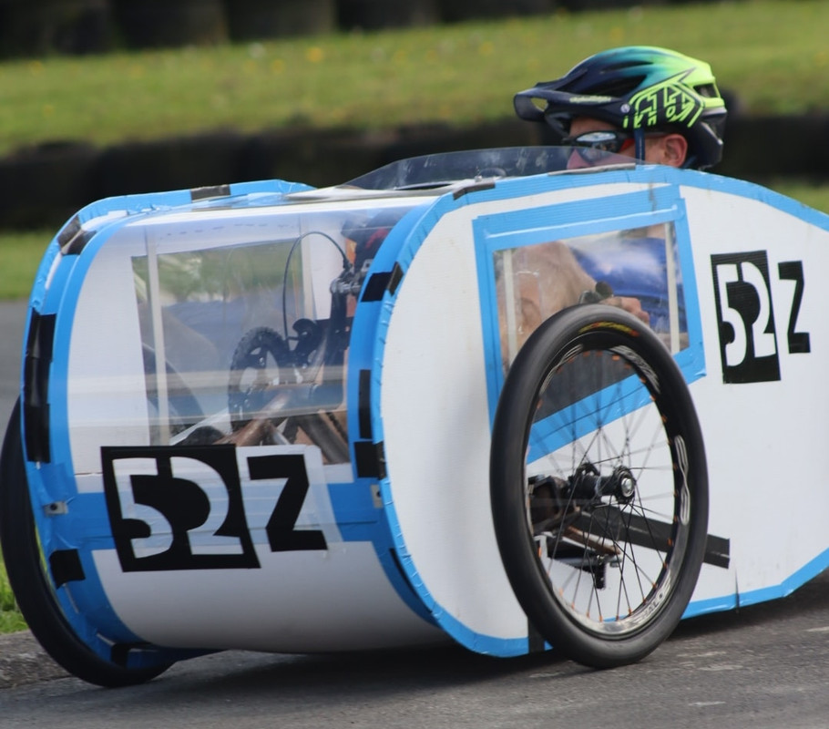

Different. At first glance it looks back to front. The openings through which you can see the knees look like side windows for viewing out.
What is the little tag on the right steering knuckle?
Old timing system tag , they ran those in parallel with a new system where the cars carry 2 tags usually on a horizontal surface , this car has those as well :-
The white blocks either side of cockpit opening towards rear.
They are issued new each season when you get your number allocated , I will have a high number like this as car was not raced last year so has no placing.
Yellow square with a black cross indicates novice driver , I won't need that ;):)
Yes at first glance it is not obvious which way it will travel , unless you know a bit about streamlining :)

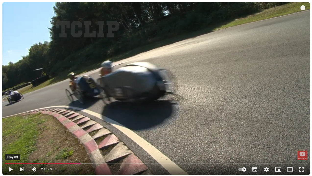

On some of the other cars I have driven you can simply lean out and see the front wheel so you can keep it on the gray stuff. Some of the tracks have vicious red/white concrete edge marks these have large drops in them to alert a go kart they are about to leave the track.
Not good for a pedal car on skinny 100psi tyres 👎
Yes your told not to run on it however other people want your line and what do you do ? hit another car or risk a few yards on this , it ain't pleasant !

Trailing edge of "flying objects" are even more important than the leading edge. (Pulling of air is harder than pushing it, if the longitudinal cross sections of both ends are the same or similar)
That one looks as light (very light) and short (very short), segment of thick (very thick) aeroplane wing?
Such body would be one of my favourites, light and aerodynamic - could be attached later on any form of chassis? For my speeds of 15-25 km/hour, aerodynamic body wouldn't be of great use, but whatever - I would like it. For racing, it is obviously very useful, especially with vertical "skirts" of some 2-3 cm around body...

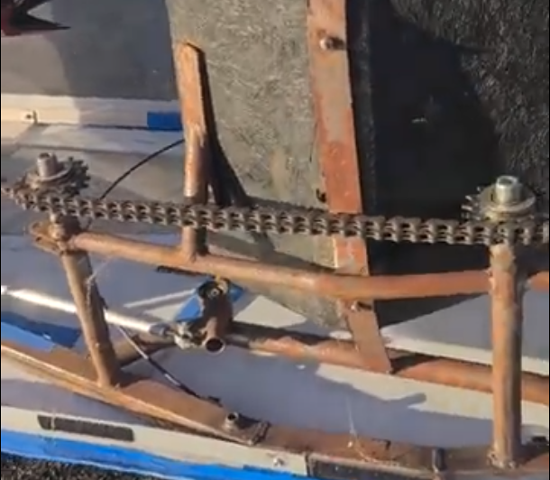

it had one problem , it could shed it's chain under certain conditions.
That one-sided strut, holding the center chain idler, is the problem, I betcha'.
I can imagine the frame twisting, and that puppy getting out of line = Thrown chain :(
BUT, as is often the case, I've likely missed something ........
I'm wondering why it runs a jackshaft. I can't see any reason for it to do so. It just adds weight and complexity, plus as said, the sigle side mounting of those parts is flex prone. Is it 1 wheel drive or a solid rear axle?

it has changed from that picture there is no jack shaft per-say just a forward pair of sprockets and a rearward pair to route the chain under the seat.
both rear wheels are driven by an expensive and now unobtainiam 2 x freewheel drive unit best part of £400 when you could get them.

Still, only mounted one side.
And it looks like it's now part of the seat frame?
I don't know if that would make it better, or worse.
There's no retainer bar on those guide pulleys. A simple bit of round bar across the back of the chain where it meshes with the pulleys would prevent the chain coming off.
