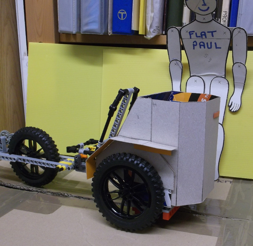

I worked on the new design and the rough base is ready.
The dimensions aren't right, but this is the base I use to work further on.
Wheelbase is 1200mm. This can still be changed to 1300mm, but I think that 1200 is a nice length. It makes it not to extreme and I can let the cargo part, stick further out of the back so I still have enough space to carry stuff.
The seat will be raised a bit and the double front will be longer. This will go to the part behind the seat.
I didn't ad the part that holds the plate yet. This is something where I am still thinking about on how I will do that. Now it can hold a plate from 1,1m long and about 1m in width.
I also didn't as the tank steering mounts yet. It comes just above the bar that is under the seat. That part that is now there, will be covered and behind the seat, will come the battery mounts.
Each side will hold a 2kwh 48v battery.
We went for tank steering because it is better to hold on as the Trike tilts in the corner.
The second reason was, that it is something different.
I will also make a box that can be mounted on the back. It will be from xps plates with glasfiber and epoxy.
The xps isolates it, is light and strong, especially in combination with the glasfiber and epoxy.
I will put a door on each side or in the back, that is something i didn't decide yet. The door will get a lock.
The last thing I ad is a removable roof with solar panels. But this will be added as the quad is ready.
Here some early images.
The part that stops now in front of the seat, will go till the back mount of the seat, that will be mounted to the rear, to get a triangle to make the frame stiffer. The seat will rise a bit, but this makes that the arms will mit hit my legs.
Springs will ge mounted with 20 to 25% tention. This will mean that the suspension arms will not be level as you don't sit on the Trike. The Trike will be level as you sit on it. The arms will still point a bit down, but not much.
The front where the pedals will come will be adjust it hight. I like it a bit higher, but it depends on the seat location.
The seat is there just to see his much space I have. It will get a hp velotechnik seat.
It isn't a racer, but it gets 3s in front and 10s in the rear.
It will be able to go fast, but it is mainly for off-road fun, transport, camping with a tent and camping with the caravan.
This Trike will easily beat the German roads.
