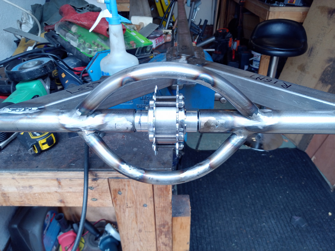

Ok, so today I played "Bob-the-bodger who cannot weld". For the life of me I could not lay a decent weld-bead.
I have no idea why things were so poor, but I have finally managed to get the parts to stick together.
I did all but 2bodges welds before the rain started and then I tried the "fat-boy-bouncing" test. By standing with both feet on the centre-joint and pogo-ing while one end was on the floor and the ends of the axle-tube were on axle-stands.
Nothing snapped or gave way (yet).
I suspect that I will have to re-do the welds, but at least the parts are now firmly attached to one another.
I was also please to find that the absolute ends of each side of the axle tube was 1,000 mm equidistant when measured from the same spot on the main keel.
So its pretty much square and may not be "crabbing" down the road when finished.
