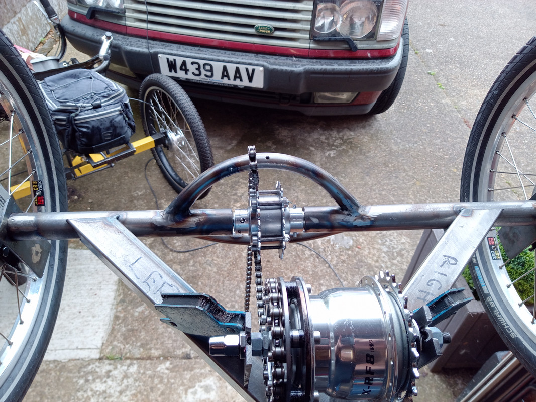

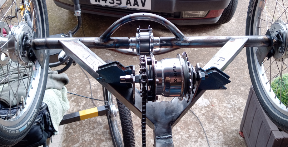

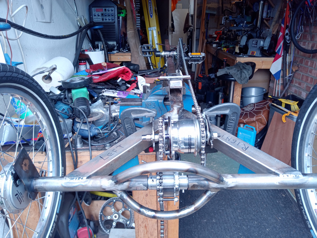

OK, today I spent several attempts at reducing the axle diameter by inserting the axle in the lathe and applying oil and emery cloth.
It was clear that the inner bearing of the pair was slightly misaligned and was causing the scoring on the axle.
I drifted it out and opened up the housing a little bit with a stone in a rotary tool and replaced it with a new bearing.
Some additional "fettling" with a large Stillson wrench on the backplate fixing tab made sure it was trying to sit square to the axle.
Span up quite well considering it has the axle and 3 bearings resisting it spinning.
This is how it looked when I decided to pack it in for the day.
