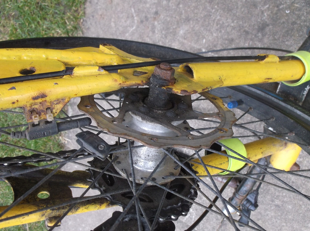

Hello, Danny. Bravo. I'm suddenly & somewhat amazed. That is definitely a duh moment. Please say if there is anything I'm missing here. This is an excellent idea, sir. With the axle solidly locked stationary, as you described, the wheel can't even jiggle, so a dial guage is the proper tool for that job. (Hang on whilst I do a few more knucklwhead duhs on myself.)I checked my SA90 Hubs for true this time by bolting the m to a 12mm hole in an piece of angle-iron in a vise.
The dial gauge let me get them to within <1mm (in fact far less than that). Simple to do, and very satisfying too.
Well everybody else manages just fine with eyeball and a standard truing gauge (which I didn't have, so this was my answer to the problem.Hello, Danny. Bravo. I'm suddenly & somewhat amazed. That is definitely a duh moment. Please say if there is anything I'm missing here. This is an excellent idea, sir. With the axle solidly locked stationary, as you described, the wheel can't even jiggle, so a dial guage is the proper tool for that job. (Hang on whilst I do a few more knucklwhead duhs on myself.)

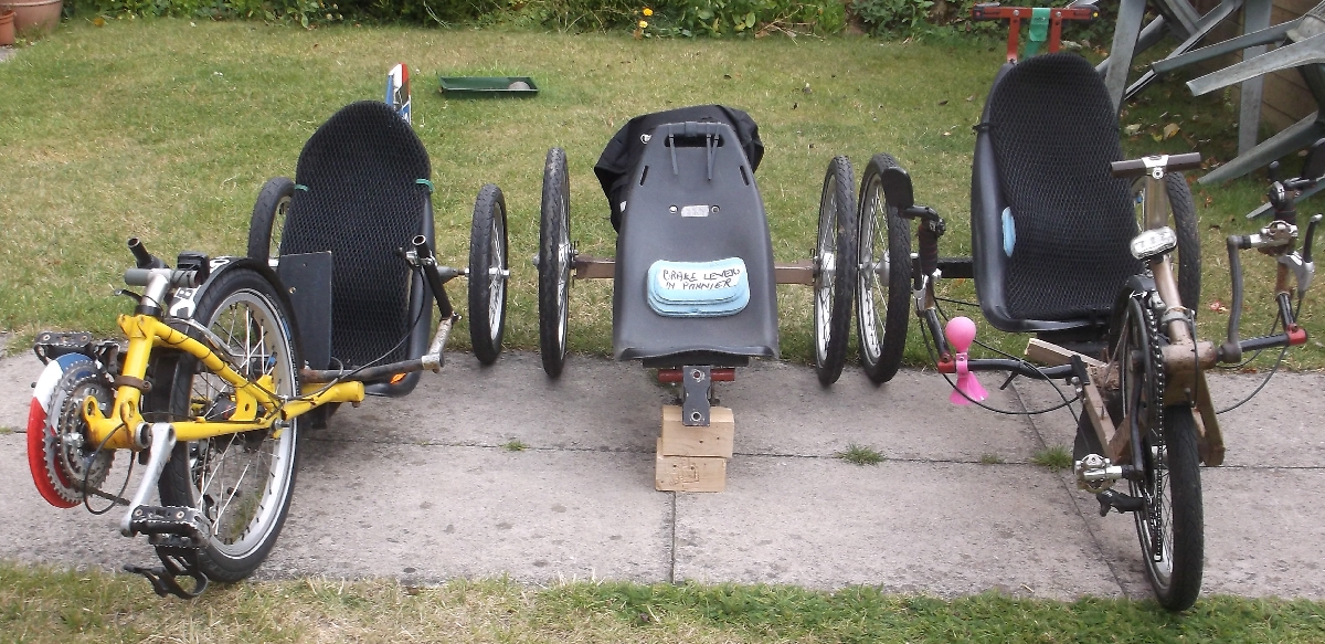

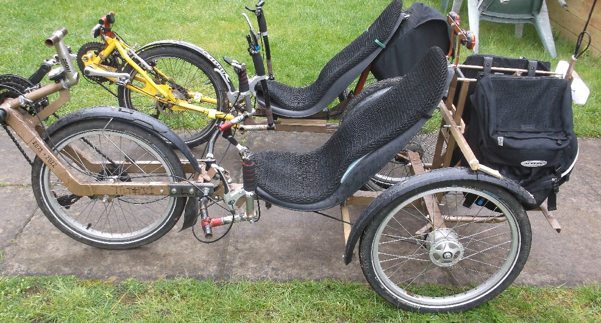

| feature | NO.T#5 | NO.T#6 |
| gears | 3 x 7 | 2 x 7 |
| luggage | 1 pannier | rack for 2 panniers may fit NO.T#5 |
| trailer towing [ my new small trailer ] | yes - probably can | yes - has |
| frame height + redundant parts + paint | low - yes - needs some - very dirty | high - no - needs some - slightly less dirty |
| handle bars | to tall - need painting | uncomfortable not sure why - need painting |
| lights | front only | front & back |
| mudguards | no | yes - wobbly & noisy |
| fit fairing ? | maybe - untried | did while building un - untried since finished |

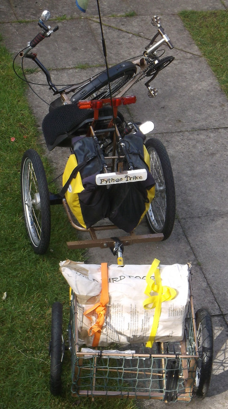

Very kind of you to offer that.I have a Nexus 8 available.

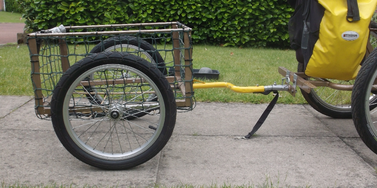

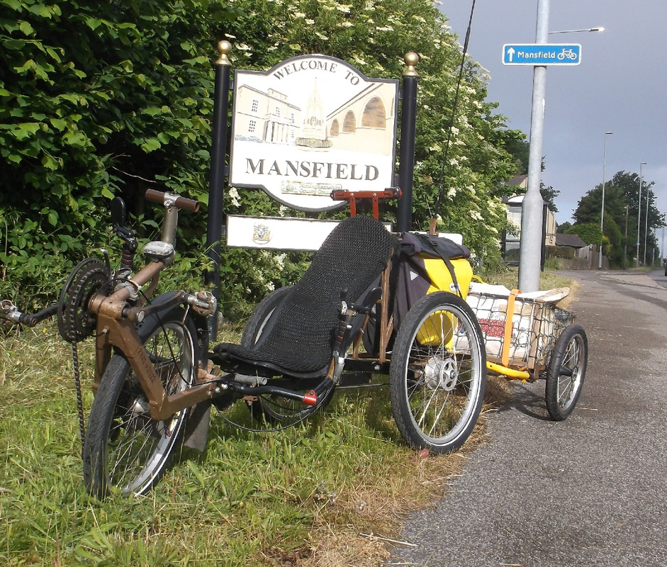

By contrast, my trailer weighs about 20Kg and is rated for 100Kg loads.Ok so wasn't happy with trailer angle so a quick hack of 2 mending plates dropped the hitch by 1.5"
Not quite 2" but close enough....
With 20" wheels trailer weighed 7.9 kg now with 16" wheels it is down to 7.15 kg
Not to shabby as a normal trailer would be about 15kg.
My camping gear weighs under 10 kg so the trailer is still over kill for what it carries.
It needs this because well....... Batteries & chargers, 5-burner gas hob, hot-tub and air-fryer.
Probably would have been easier to just put Pauls stuff in my trailer and let him tow it all.![]()
