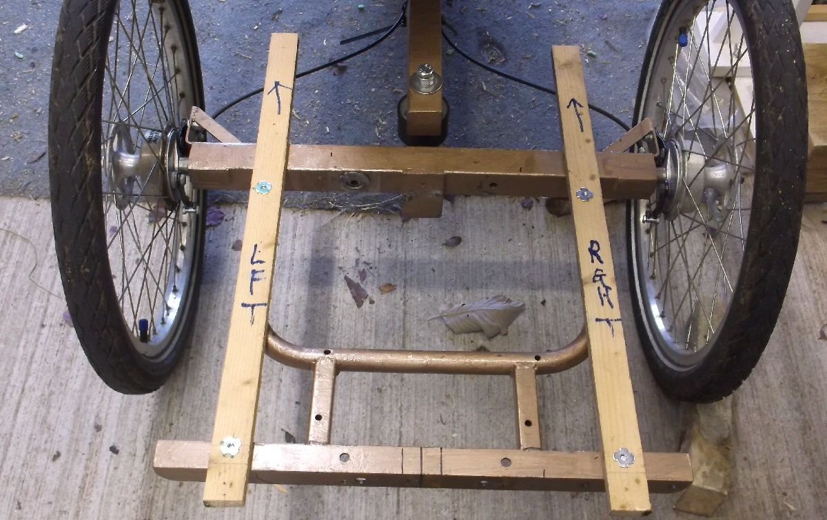

The beauty of modular trike's and being at it a long time means useful stuff is just lurking in the bike sheds.

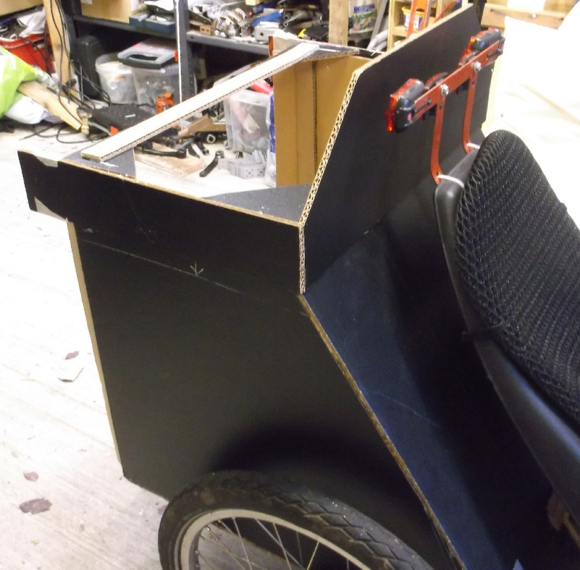

This frame will form the basis of the fairing mount.
Strewth you would think it was made for it.
So I need to lathes front to back M6 and T nuts holding the lathes to the steel frame and 2 pieces of 3mm plywood on the fairing floor and lots of small screws should work.

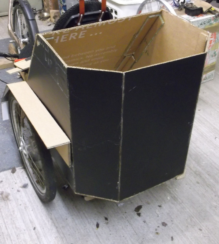

just dropped on the new mudguards for a look , obviously they need to be about 1" above the wheel still looking good.
I think the faring is a bit high at the moment , my shoulders are below it so may need trimming ?
