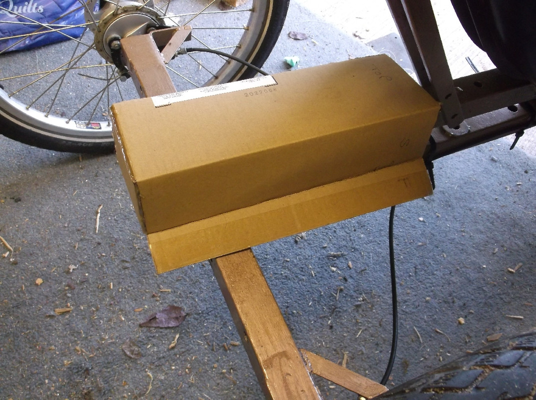

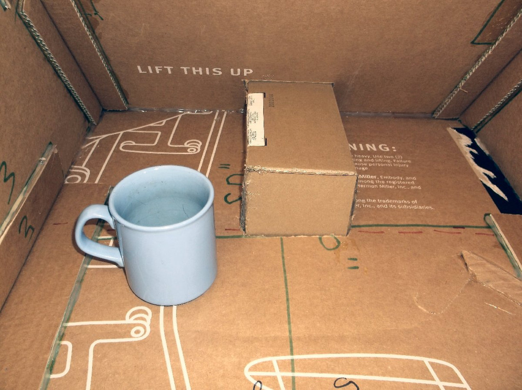

Not sure yet how much space to leave behind the seat , however I still need a sort of transmission tunnel to allow the rear seat sub-frame extension to pivot freely so part 1.
What a crap picture , here it is inserted into the floor/sloping front.
Whist it looked big it is surprising how little room it takes up ?
Needs gluing in and the seams given an outside hot glue fillet to stop water ingress.

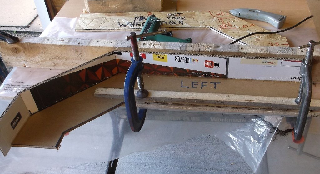

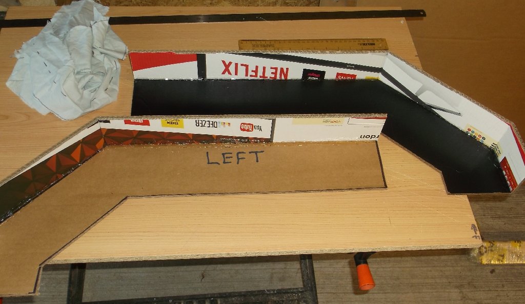

So a Blue Peter moment this afternoon when I got the wheel arches built :-
Knocked up a template from some scrap wood and cut out the 2 bases.
Because cardboard bends unlike plywood the upper part can be made from a single piece and glued on with a hot glue gun , seems nice and rigid.
Then I commandeered the wife's pinking shears and attacked an old bed sheet strips 4" wide were cut with a centre line , these will wrap all corner edges before the flat surfaces are tackled.
The complete kit for 2 [ notice I managed to build two handed mudguards instead of two the same side [ that's a relief ]].
