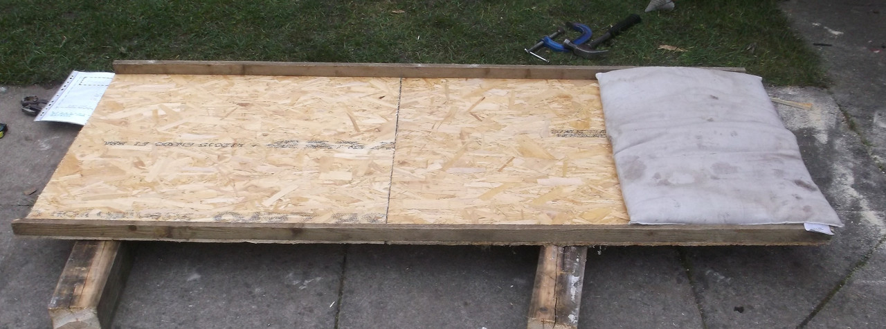

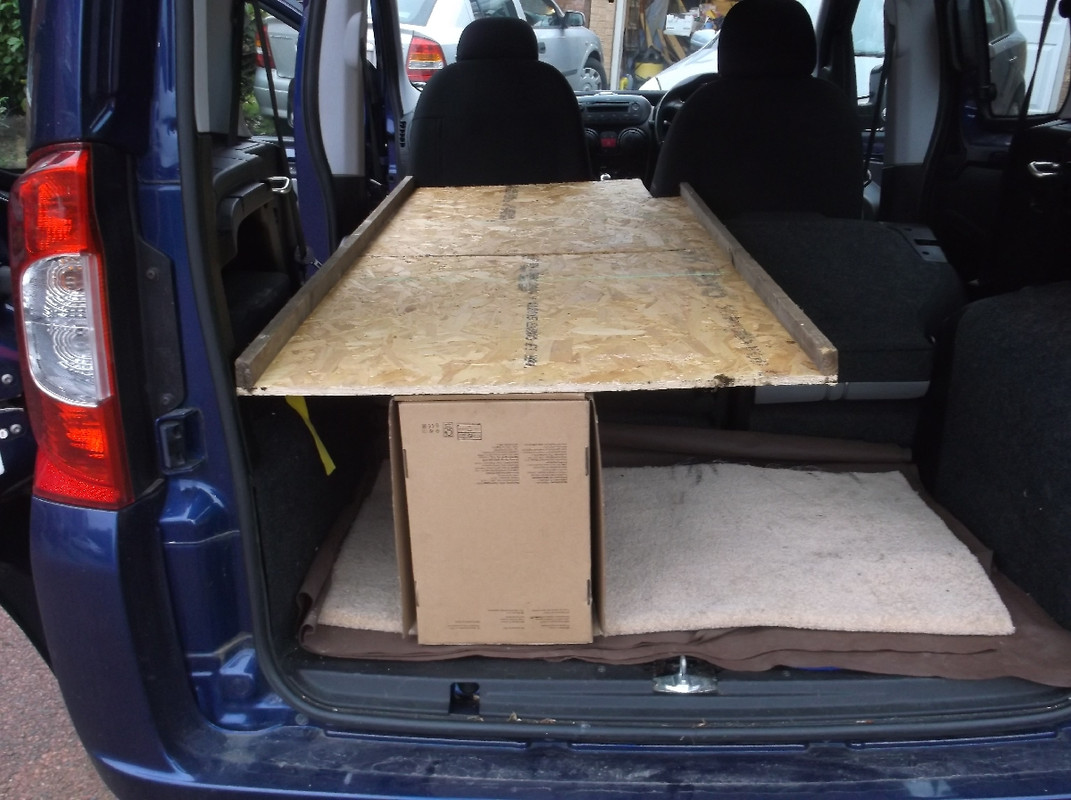

Next up can I get a platform 72" long and 28" wide [ airbed sized ] into the car and still drive the car ?
The proper one won't have side rails they are just holding 2 bits of OSB board together , as you can see barely wider than an old pillow.

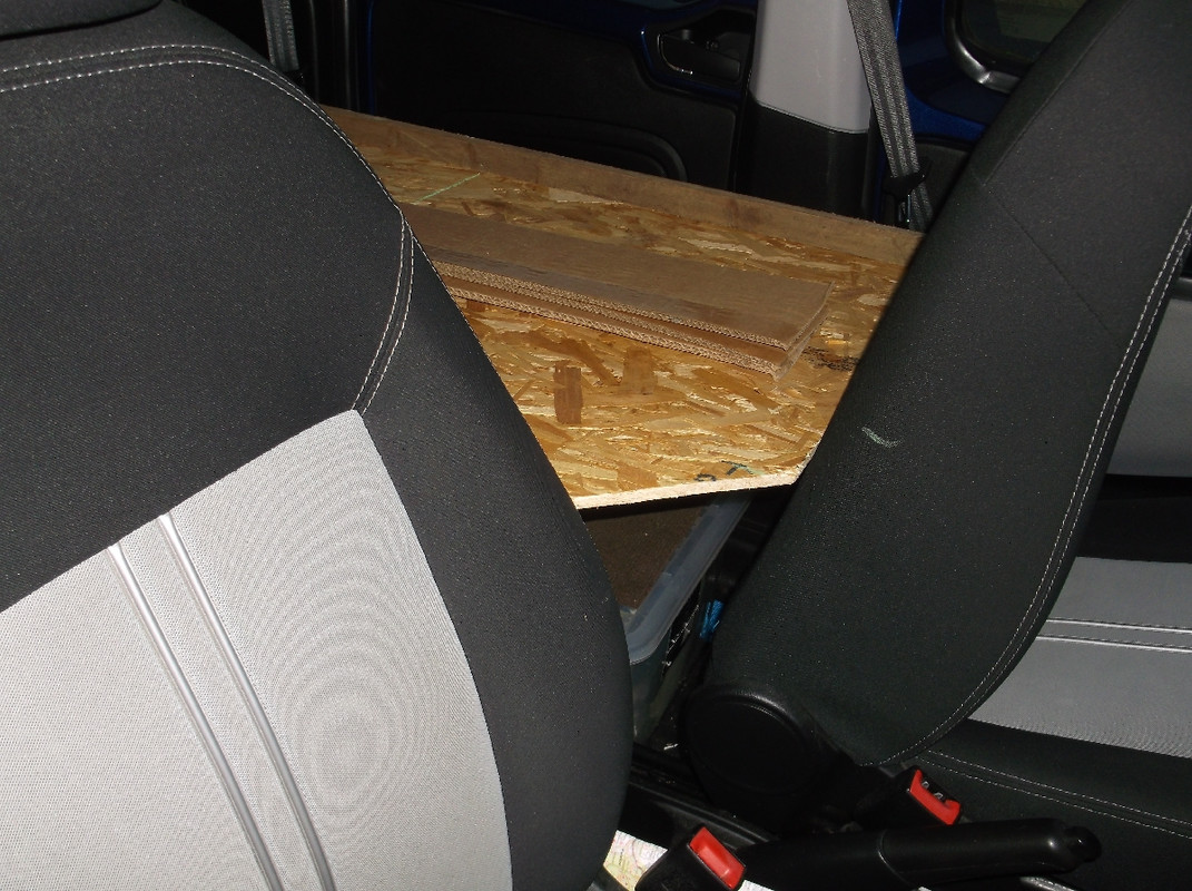

yes it fits I have had to trim a small piece off the right hand end to clear the front seat [ approx 12" by 2" ] this will be the leg end so good I think and the seat side is
soft should I clout it with my feet. As can be seen on the right the rear 1/3 split single seat is still in , I will remove that and then I can enter by that door and get down the side of the bed. There will be a little room to sit up hunched over on the bed so allow some room to get changed [ well much more than the tent ] when spending the night in it.
So airbed can be inflated at home bedding put on and sleeping bag prepared all before I leave.

Neatened the front corner and tested it as I had to drive it around to the next cul-de-sac to find anywhere approaching level.
No problems so that's a result.
It can be seen that is resting on the top of the back seat backrest and the sloping back of the front seat so this is where I need a sort of frame/trestle support to take the weight. Was able to measure this height [ as the base was within about 1.5' of being level ] @ 21.5" [ 54.5cm ]
Temp support at the back door end shows the drawer/main support unit needs to be @ 13.4" [35 cm] from floor and 22" [ 56cm ] deep.
With that i can start drawing up actual wood sizes/pieces that I need to by
Oh platform is 3 pieces 22" x 28" hopefully a single sheet cut at the suppliers will provide the top and maybe bottom and rest to be built from scraps.
