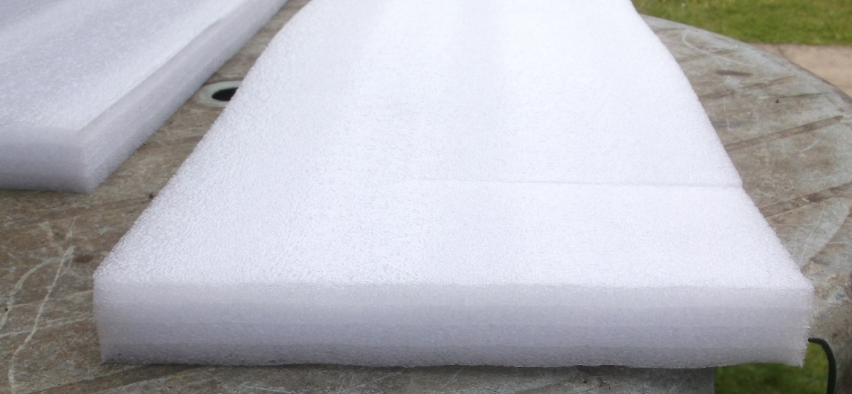

Having some plumbing work done I have some of the packing plastic , however it is not polystyrene but that grease harder plastic for absorbing impact ?
However what is it called ? does it actually have any insulation value ?
I think for £14 I can get two sheets of 1" [25mm ] which I need to calculate the interior volume of when turned into a giant shoe box it might just be enough and thick enough when doubled up.

Do you have a photo?
I've seen some flexible polyethylene foam used for packing - I'm sure it has insulating value, as anything that traps air should.
That's the problem I am not sure it is a very good insulator as there are no air bubbles visible ....
Oh and it is very very hard to photograph ;)

That's the stuff I was thinking of - Polyethylene foam.
It definitely has air inside it - If you threw it in water, it would float like a cork, from the trapped air.
R value = 4-6 per inch
Same stuff pool noodles are made of, and it does have a good amount of R value.
I did all the pipes in my house with pool noodles actually!
You can get "proper" pipe insulators for about $1 / foot at the hardware store.
But you can get 4 foot pool noodles on sale in the fall for about 4 for a dollar.
Since my house is 80 feet long, this was a HUGE savings, plus they are larger in diameter.
But the point of that ramble was that your foam is the same material, I recognize it.
