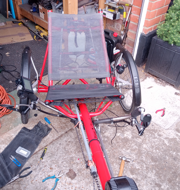

The picture below is of the underside of the Kett's seat-base section.
The centre section is comprised of a double layer of phifertex folded up into an oblong tube.
There is an additional section sewn onto the leading face that was once elasticated and is pocketed to fit over the horns of the seat frame.
At each side of this panel are/were a pair of elasticated loops made from upholstery webbing.
The elastic has long since stopped responding and the seat is just a very saggy mess that allows one's posterior to "bottom" out on the frame [see what I did there?].

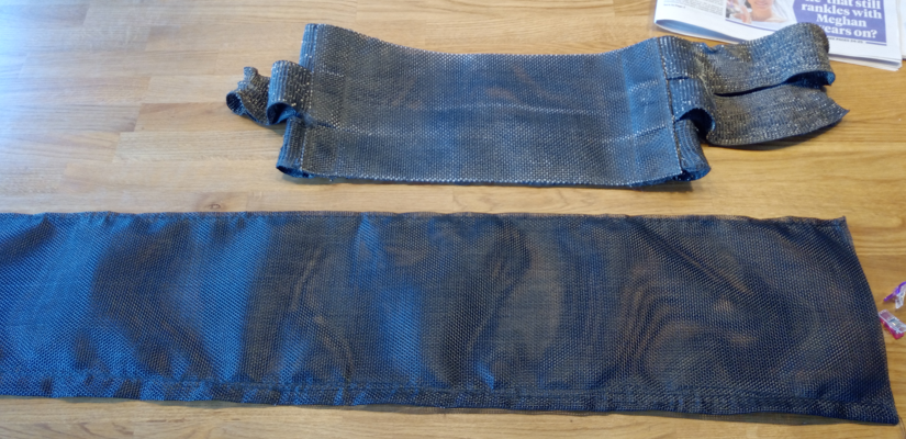

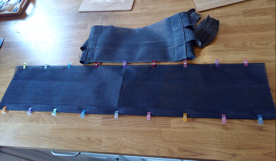

I got the Phifertex out today and set out the basic shape.
I have made it 2-layer with an additional folded front seam that is 4 layer as that is where the most stress will be.
It is made like a long tube-sock and then I will fold both ends back over themselves and double sew that.
The pockets for the metal rods will be formed at the very ends of the fold.

Here is the overall "tube-sock" of Phifertex. There is a folded-over 4 x ply long front edge and just a folder over once long rear edge.
Pretty it is not. I'm a novice sewing contraption user and it's only a cheap Chinese shoe-patcher manual sewing machine.
BUT, I think it will be just as strong as the original, if not stronger. I need the steel rods ASAP to move forwards really.

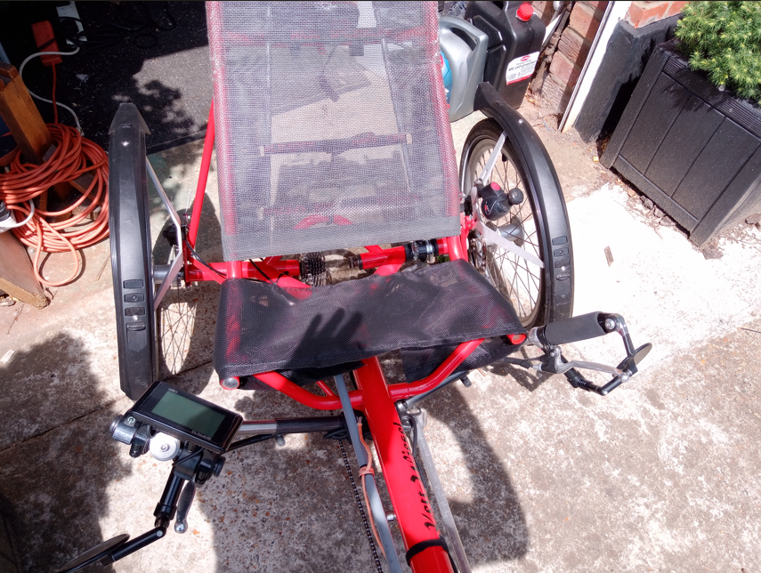

I shall however place it on the seat frame and pretend it is done. :)
.... like this.
The new seat mesh is on. :)
This morning I sewed the pockets for the stainless rods.
I started trying to fit it to the trike at about 12 and it has taken me 4 hours to lace it up.
I may have made a mesh [sic] of it.
It isn't as rock hard as I thought it might be and I struggled to draw the lacing super-tight.
At the moment the lacing is only held by a non-slip double-hitch knot.
According to the internet, Paracord has up to 30% "give/stretch" so I think it is a good idea to let it settle and then re-tighten later.
Is it an improvement on the previous arrangement? Yes, definitely.

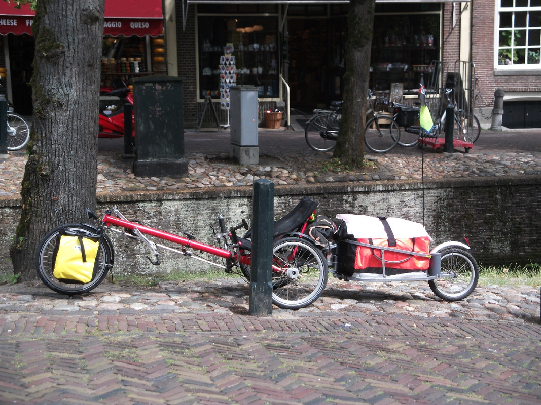

Not having a sewing machine I used 10mm bungee cord and laced both the top and bottom of mine with it , it looked uncomfortable and it seemed like that for about 10 minutes of every ride then you forgot all about it and got on with the job.
So my Kett can be seen on the right with a bungee seat back , I am the geezer on the left in the picture .
Also of interest the geezer on the right has sold me the Kett on the left , the first time I went to the Netherlands I used that trike !
I carried far to much stuff in those days , still we live and learn.
Ain't it a small world.....
