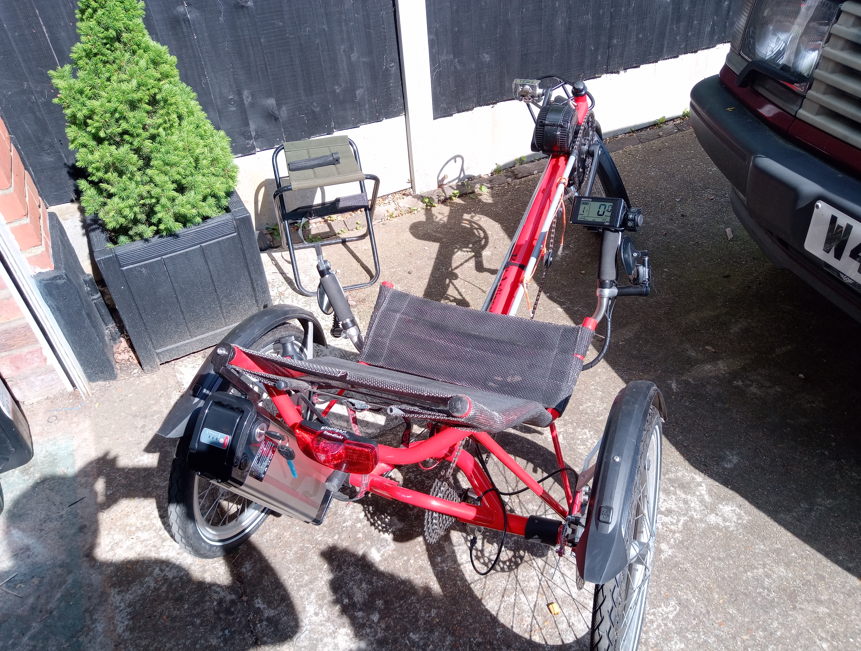

To this end I have cobbled together a battery rack for the Kettwiesel. That is a single 15AH 36v "Silverfish" battery.
The real weight of the battery is resting on a cradle/foot that fits over the axle-tube, it all seems fairly solid.
Now I need to finish off all of the wiring-up to the brakes, thumb-throttle etc. etc.
Ah I can see now what you have done , I did think the battery was going across the axle.
So I assume IF you wanted you could have a second battery on the other side , or even a pannier ?

Well chaps, look at this bit of Tomfoolery we got up to today. A working e-bike. :cool:
I even set it up for "Miles/MPH" and 6 power levels (not 3), 20" wheel size and Max Spd 32MPH (Ha! Ha!).
