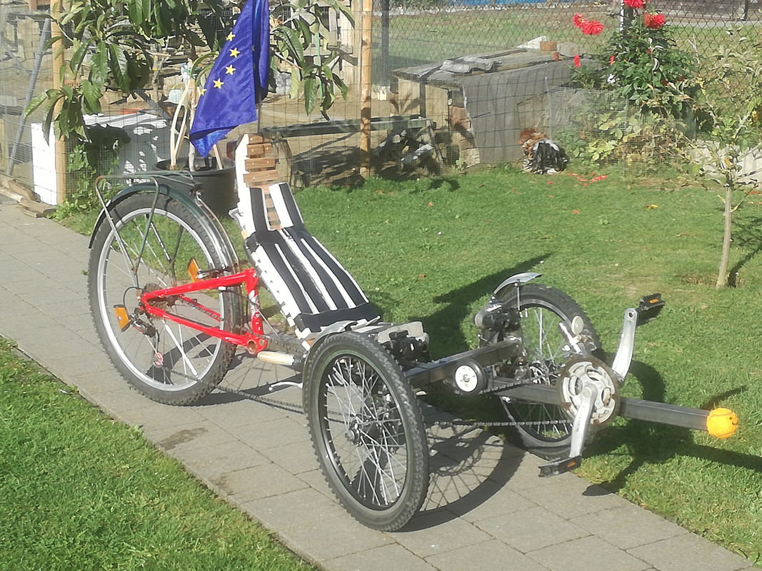

Hello,
This is my first attempt to build my own recumbent trike.
Dreaming of a recumbent for years, I purchased a six pack many years ago. Now that I am retired I started the adventure. I bought a stick welder, 6 meters of square tube, and started to cut some scrap bikes into pieces.
This picture dated from October last year. I drove about 300 km.
Currently I am dismantling the bike in order to clean up the ugly welds, to improve some chain management and to prepare everything for the paint job.
I will post some new photos when all is done.
Jan
Love it! Even rockin' the fenders!
Nice touch with the smiley tennis ball bumper, too! :)
Lookin' forward to seeing pics of the "refined" version!
