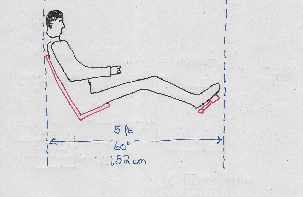

So first thing to do is look at the engine and it's mounting [ i.e seat ]
Now the 60" is not fixed and depends on several variables some change able and some constants ?
ConstantsVariables
Leg lengthSeat back anglethe more laid back the seat back the longer the engine becomes
foot lengthPedal crank length [ not really ]short cranks just move BB forward , maybe useful ?
height difference between seat base & BBObviously if yours knees were bent 90' it would considerably
shorten the trike at the expense of more height and less power
From the example above it can be seen if the rear wheel axle was on the left hand dotted line that would add 1/2 a wheel diameter to the length 10" [ 25cm ] for a 20" [ 405 ] wheel
If a normal fork was mounted in front of pedals 2" [ 5cm ] for clearance and a 20" [ 50cm ] wheel adds another 22" [ 55cm ]
This gives a total length of 92" [ 232 cm ]

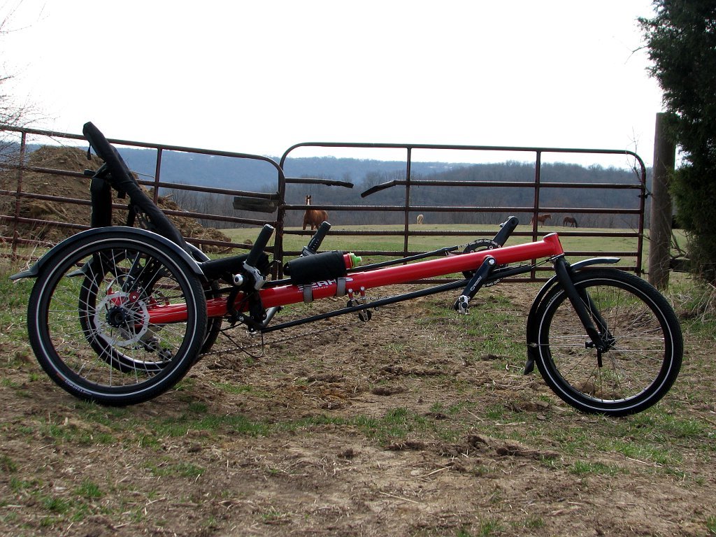

Strangely the Hase kettweisel has a total length of 81" [ 205cm ] probably because the pedals are raised and so half the wheel width is under the pedals.
This is Brad's DeltaWolf which will be longer than the Kett due to the lower pedals , also this show's well what happens as we bring the drive wheels under the seat to shorten the trike.
The plus side is the engines CofG comes closer to the axle so increasing stability in corners [ sitting on a wider part of the stability triangle.
the negative side is the wheels can come in contact with the elbows.
On a home build that is not much of a problem as body work i.e fenders can be built to stop that.

The videos of it being ridden on a BMX track were frightening , I suspect it did fall over just that bit was edited out ?
and yes it is VERY short maybe a crazy 30" w/b hence the height
