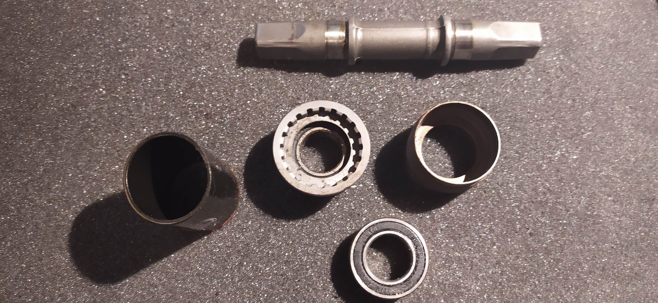

It is a scrap bottom bracket, bearings full of sand, I just wondered if you could attach a chain wheel in the middle of the shaft?
Can you weld the shaft? Only one way to find out.

You can't just post this picture and NOT tell us how you got it apart (n)
It looks most useful now apart , I can see it being good for a pedalo style pedal assembly and making a narrow BB to lower the Q measurement ?

Cut in half with the square end pointing inwards ?
The bearings are 173310, 17mm id and 10mm wide, a pillow block bearing with 17mm hole is 22mm wide.
So the bearing stopper has to be removed.

If I filled the gap between the bearing stoppers with weld and then machined down that part to 19mm, I could attach a chain wheel in the middle and run the chain thru or over/under the frame.

Does it ? it looks like the bearing would sit in the gap ? the pedal crank could also have a little meat removed from the inside ?
