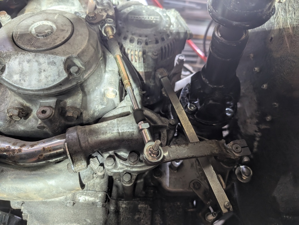

Got the shift cable bracketry made and the lot transfered to the installed engine. The propshaft misses everything nicely but it's tight to the top of the tunnel meaning some very ground down bolts will need to be used for the shifter. Those bolts will have to go in from underneath and the nuts on top which is less than ideal aesthetically. I'll weld some thin washers together in pairs and then weld the bolts to those so I can grind down the heads to the minimum. It's not a lot to show for 6 hrs work but I did shift the parts engine to the shed to free up some space as my back will testify. Tomorrow I will start on the dash and seats.
